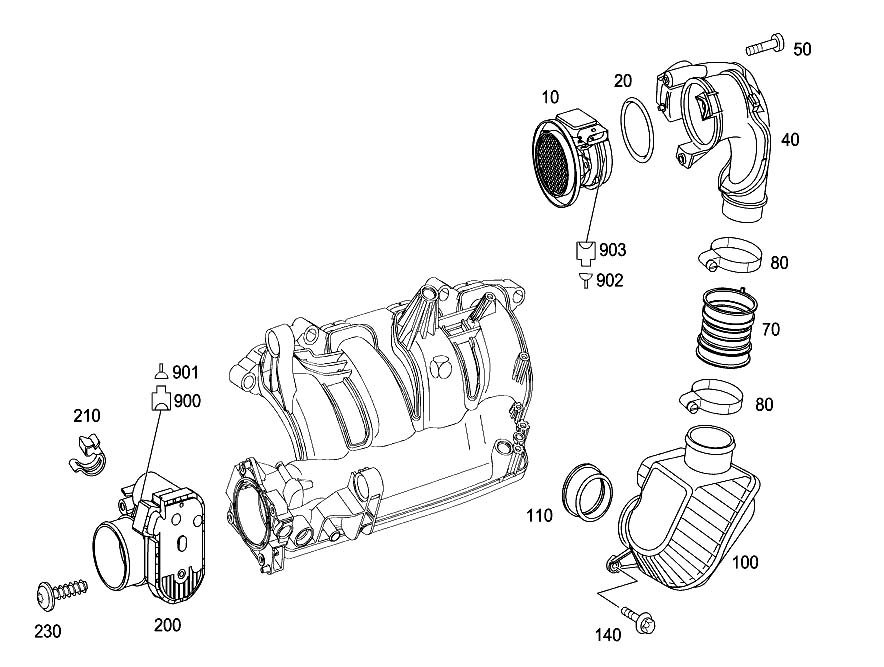

Yeah, so I checked and my car and it has the factory hose clamps as you described rather than the worm clamps shown in the pic (#80). So it's a good thing you told me about that.
I'm hoping that I only have to take the top one off to get the air filter housing out. I see a bolt #140 holding the bottom air filter #100 to its gasket #110. How does that part come off...will it just slide out once bolt is out? I don't see a clamp or anything.
Aug 27, 2020 at 6:23 PM
Yes it will slide off and outward from the boot. Nice work getting the images. We will get this problem fixed yet!

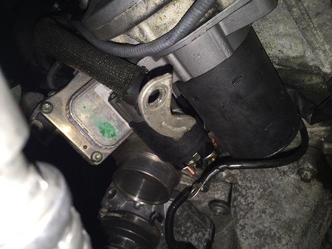

Alright, so here's whats happened since my last update on the starting problem:
After some seriously painstaking work managed to get the starter out. I took it to my local autoparts store for a professional bench test. The test confirmed that the starter was fried--the starter would not even turn (so maybe problem in the starter solenoid).
So I already had a new unit on hand, and again, after some serious labor, managed to get the new starter unit in. Once that happened, car starter right up! It's like it never had a problem!
So I gotta give you credit, you were spot on on this one!
KEVINM01
  • 63 POSTS
I was worried my steering would be off balance, but I had locked the steering wheel and tied it down with the seat belt, prior to removing the coupler. I drove around on the interstate for about an hour, and the steering seems
There are a couple of difficult parts on the starter removal/reinstallation:
1) getting the lower bolt on the intake muffler (the belly of the muffler is in the way) I had to use a 1/4" extension to access it, but it took a long time to get it off.
2)getting the main power supply off the solenoid. it has a protector on it. i had to cut it off, before being able to get the clips off to remove it. but you can't fit a socket/wrench on the nut without getting that protector off. you'd probably have to remove the supercharger to get it off intact. the power supply cord sits towards the passenger side on the other side of the solenoid, so you can't see it when you are taking it out or putting it back in. I unbolted the starter first, before taking off the lead, because I couldn't see it.
3) repositioning the power supply to the solenoid back when putting back the starter, and getting it to fit into its position. hooking the power supply back up to the solenoid is difficult, because it's a tight space. I had to simultaneously put the lead on as I positioned the starter, because otherwise you wouldn't get it on there and get the wire in the right place. and if it's in the wrong place, then the intake muffler doesn't fit back in.
4)removing the steering coupler, very tight space, and you need two wrenches socket, cause there's a bolt on one side and a nut on the other side.
5)dealing with the factory hose clips. there's a learning curve for using the tool to get the clips to do what you want them to.
KEVINM01
  • 63 POSTS
You can see the unusual shape of the main power supply to the solenoid. If installed incorrectly, then the cable is in the way of the starter or intake muffler. It's tough getting it back on. It's even harder if you put the protective plastic back on the elbow of that cable.

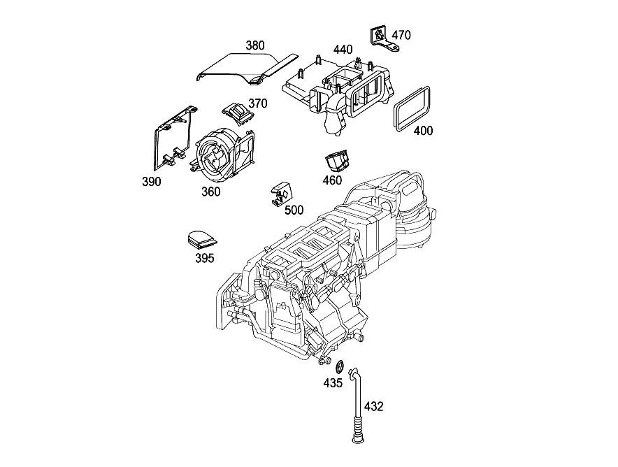

Can you point out the tube to check? http://www.mbpartsworld.com/showAssembly.aspx?ukey_product=7631671&ukey_assembly=1083530
MHPAUTOS
  • 31,937 POSTS
Can't see it on that pic, but there will be a small drain tube to allow condensed water that forms on the evaporator to drain away, there will be a small tube through the floor or the lower part of the fire wall at or near the evaporator housing.
KEVINM01
  • 63 POSTS
Ok, I really hadn't the slightest clue what you were telling me to look for. Are you talking about #432 in the picture?
If so, how do I access that?
it is part 432, install the leak detector in there

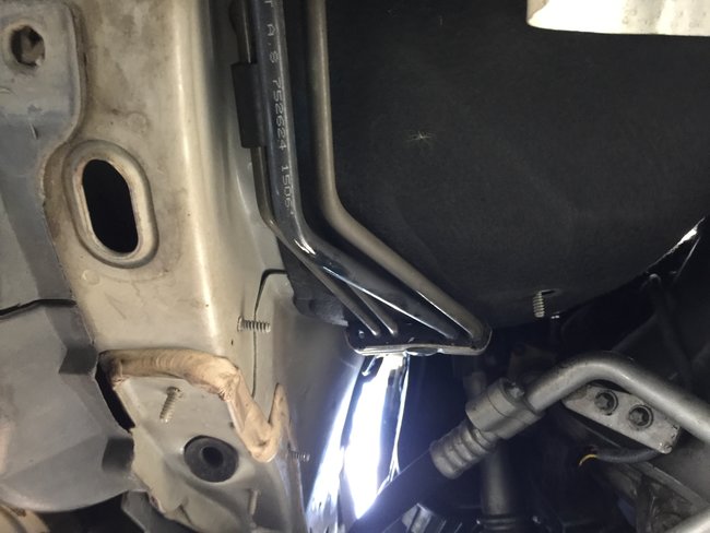

You will have to locate the outlet under the car, the pic will give you an indication to it's location you will probably only see a rubber grommet with a small rubber hose protruding only about 2-3 mm
KEVINM01
  • 63 POSTS
I mean you've seen a C230 and you see the diagram...where specifically do you think it comes out? I've looked under the vehicle, I don't see anything.
In my opinion, it either comes out on top of the transmission directly. Or it drains onto something else, which drains out of the car.
There's no visible opening that I can see under the vehicle that is THAT hose. But I'd be interested to hear where you think it is.
KEVINM01
  • 63 POSTS
Do you know what this oval opening is? I saw that. But that was the only thing I saw.
There's a hose that drains outside of the windshield to the bottom of the car. I also saw that one.
But no visible evaporator drain hose.
