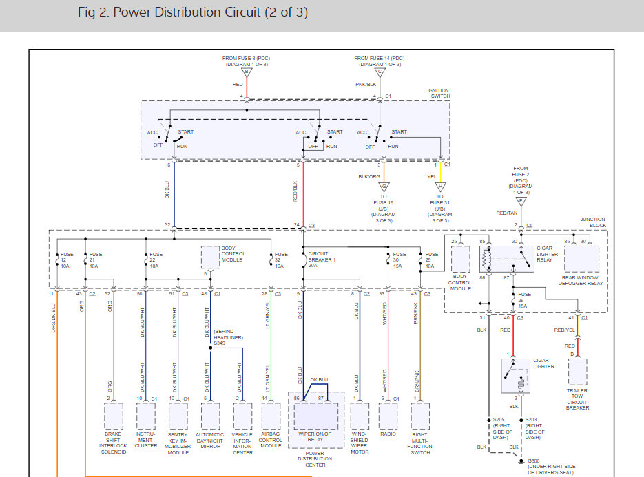

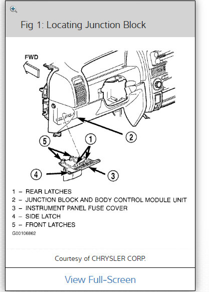

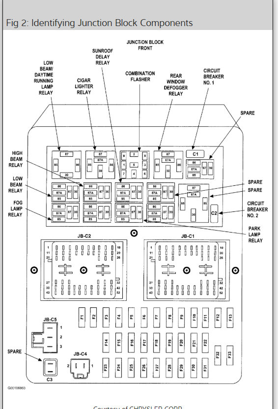

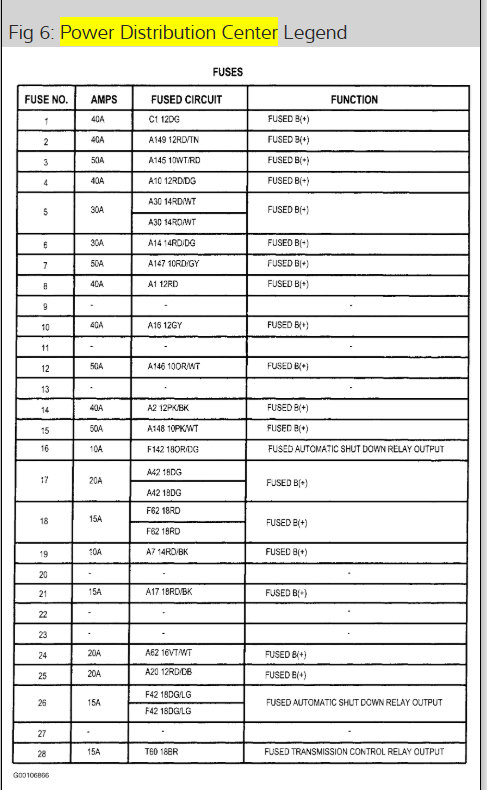

This sounds like the instrument cluster has gone out or the ignition switch needs to be replaced. To be sure here is a guide to help you check the ignition switch. Have you checked all fuses? Here is a guide to help with that as well. Also clear the codes and then turn the key on to see which codes come up first.
and
and
Oct 28, 2019 at 12:54 PM
CASCHOM
  • 27 POSTS
My ignition switch Mopar is brand new. replaced recently before the problem.what is the cluster? yes all fuses have been checked. i can't check relay don't understand how.
Why did you sent me these diagram?
Nov 2, 2019 at 9:04 AM
The cluster is the instrument cluster, sorry, I gave you the diagrams so you can check the fuses before we continue. Let's clear the codes then turn the ignition key on without starting the engine and then run the codes again to see what comes up. this will be hard code which needs to be addressed first.

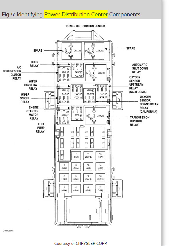

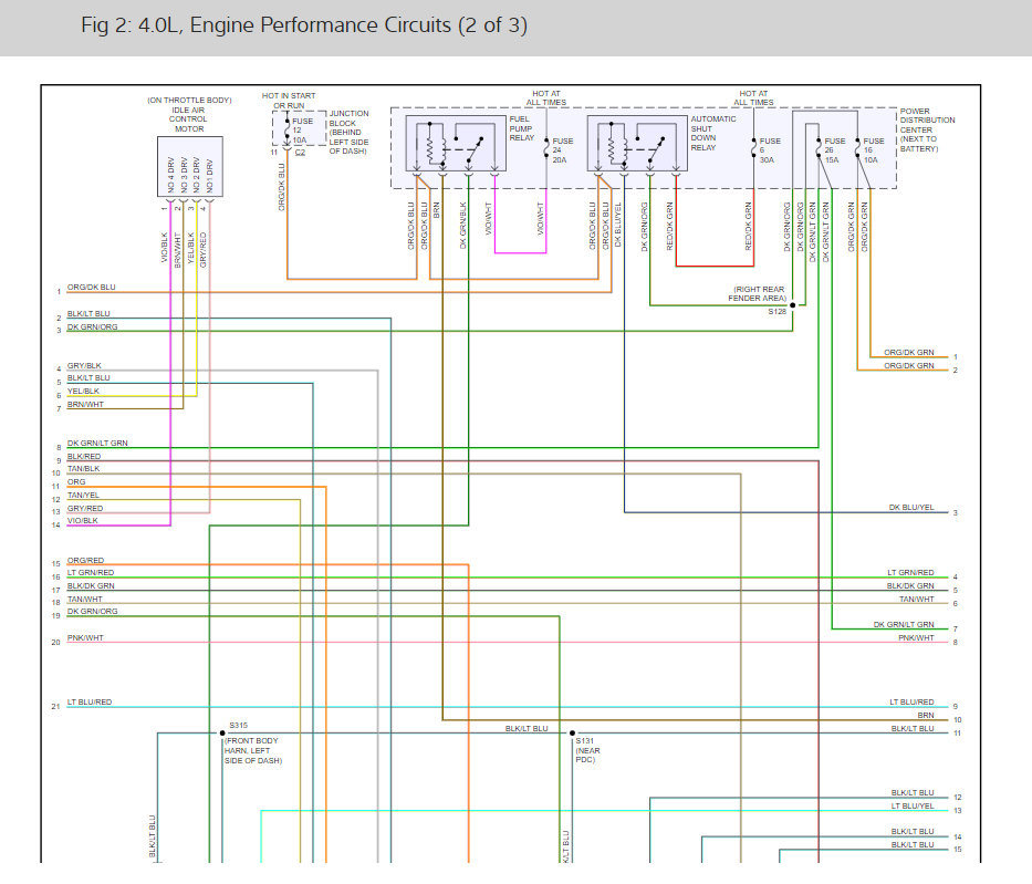

No power at the coil is telling us the ASD relay might not be working. check the diagrams above for the relay location and use this guide to help you test it:
Nov 26, 2019 at 11:41 AM
CASCHOM
  • 27 POSTS
ASD Relay tested , it is okay.

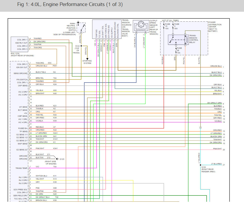

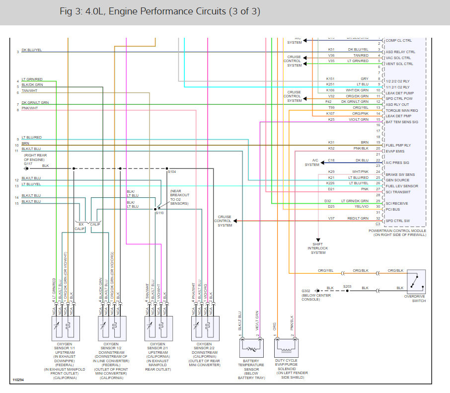

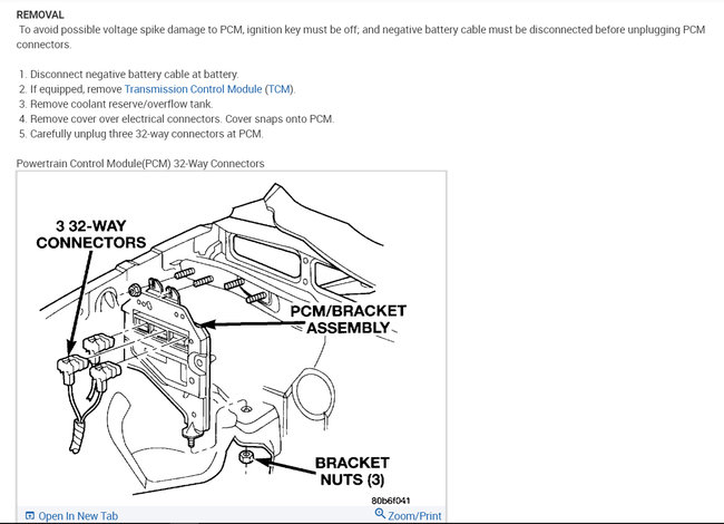

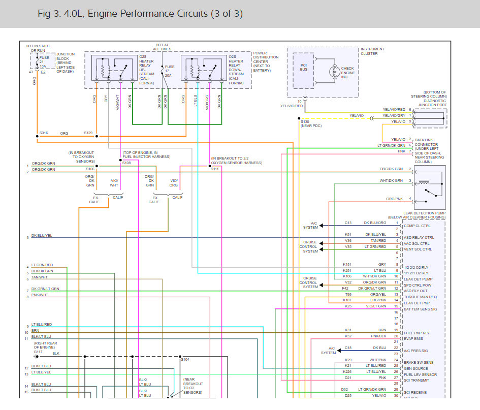

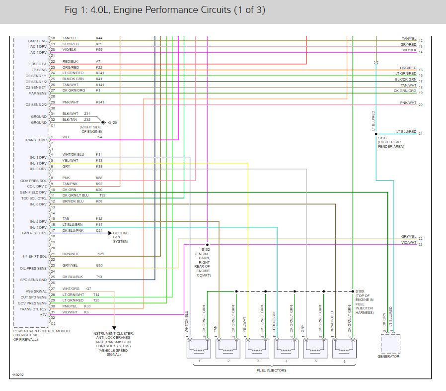

Here are the PCM wiring diagrams. please go over them using this guide to see if the PCM is getting power and ground.
Jan 16, 2020 at 10:10 AM
CASCHOM
  • 27 POSTS

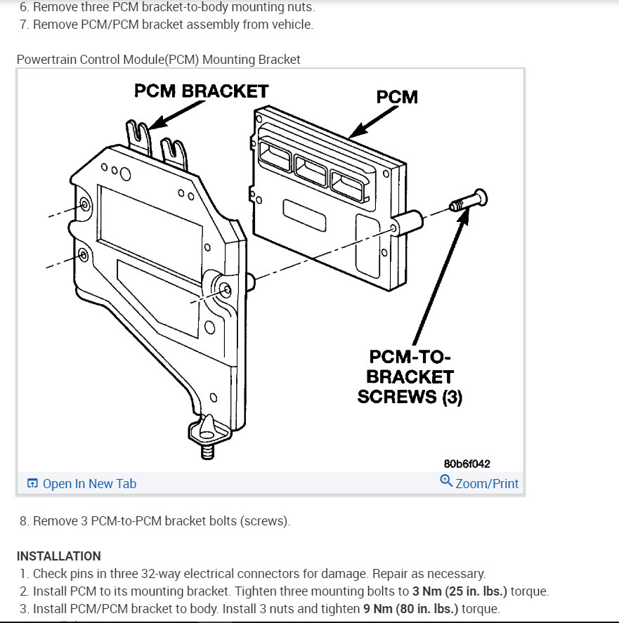

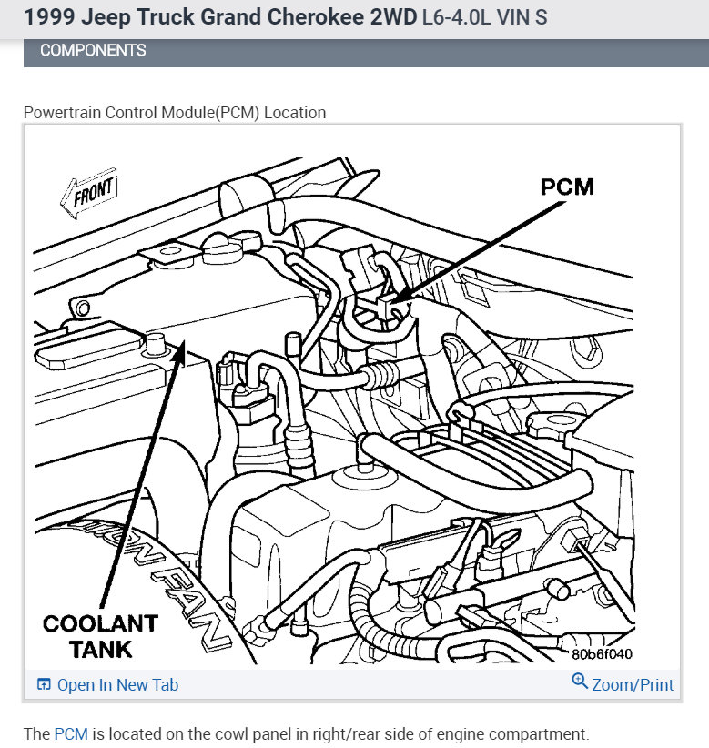

where is the PCM located? what is it ? i already tested all electric outlet: cam shaft sensor ,crankshaft , injectors they all have dc electricity except the idle throttle. is it a problem ?
Jan 18, 2020 at 1:22 PM
Here is the location of the PCM and the instructions on how to replace it. Check out the diagrams (below). Please let us know what happens.

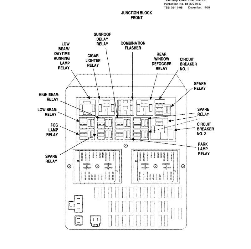

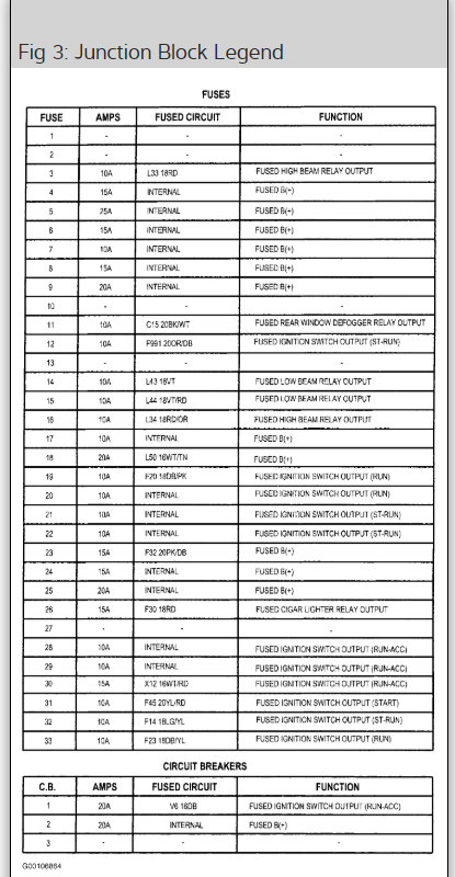

i didn't test the PCM wiring yet a lot of wires r very dirty and not easily identified , i tested the fuses inside the car next to accelerator , just discovered them , i found a lot not working
(i had not tested them yet ). these are my findings using my light tester and putting the clip in ground:
First row (lower)of fuses
Ne (=no electric) in 31
all good except starter fuse #31
Second row
Don't find electricity in 14,15,16,.. 19,20,21,22 (ne= no electric)
17, 18 test OK
Third row 3 ne
OK 4,5,6.7 ..9
8 électricity one side (lower) i had to take it off bkz roof always stays on
11 hbl (no electric).
the front light don't work same as windshield wiper.
the roof light stays on all the time had to take off fuse.
there are also a lot of relays i discovered inside can you show me a diagram where they are all located and their uses. i took them off to verify and clean legs of small one but am not sure of all positions when putting them back.

yes same number of cluster (i already answered but don't see it). i tested all fuses No electricity in #3,11,13,14,15,16, 31, find in 8 lower lights always on.
